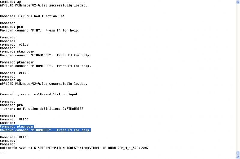

Dear Lee
I already load .lsp file downloaded from your page in Autocad 2007, but unfortunately it didn't run and promt as we seen.
I'm a newbie. Pls. help me to solve this. Thanks in advance.
Hi TheWhiteSand - Welcome to CADTutor.
How are you loading the program? - did you download and save the LISP file to your computer, or copy/paste from a browser window?
Lee
