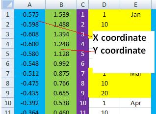

Ugh, what a headache.
I keep getting Bad argument type
I'm trying to insert a block called sun position.
My spreadsheet shows the sun position every 3 weeks for the year
x coordinate is column a
y coordinate is column b

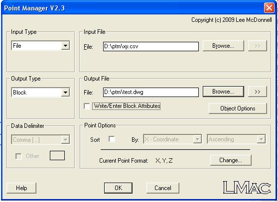

Lee Mac,
I have stumbled across your program in trying to import 24 points of which I have northern and easting into my CAD drawing. I have downloaded the V2.3 but have no idea on how to run the program. I saved it locally and when I click on it I get a notepad open. I am assuming I must run this through ACAD but have no experience in doing such.
Please help!
Emery
Lee
I got it working.
In the dialog box, I put the drawing that I was in (test.dwg) as the output file.
I tried it again and this time I used the wblock sun.dwg as the output file.

More specific info...
I am getting the following error:
** Error: bad argument type: numberp: nil **
I renamed my columns from northern to Y-coordinate and Easting to X-coordinate and my point number column to numberp and still get the above error.
Hi Emery,
The program works best without any headers, just the raw data. Its obivous from the last couple of posts that I need to revise the code slightly to deal with these few bugs, and I am surprised that I didn't spot them before...
Let me know how you get on,
Lee
I've updated the code to Version 2.4, this should hopefully fix these recent issues :)

Thank you for your code.
But probably I'm not understood very well how it' works.
I have a dwg open.
I run ptm lsp.
I would like to extract data from a block, manipulated the data with excel, and reinput data in the the same blocks in the same dwg.
In order to do this below the operation:
1) Select INPUT block and output file, file created ok.
2) Manipulate the file, save in the same way (delimited).
4) Select INPUT file and output block, the block name it's the same of the previously selected.
In this way I'm aspect that the modified data in the delimited file will be replaced in the same block.
It's true ?
Thks
The program will insert new blocks in this way, but will not be able to manipulate existing ones.
