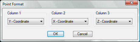

Point Format Dialog:

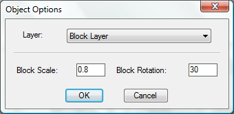

Object Options Dialog:

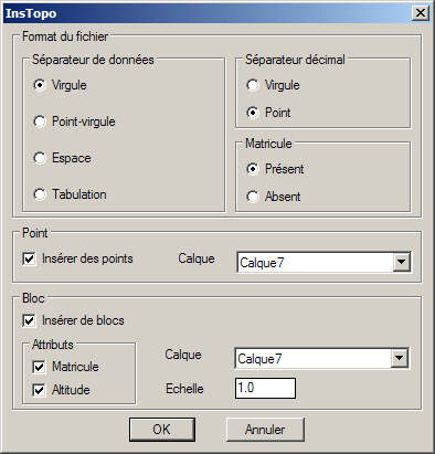

Gile, wish I understood french, I can make it out though. Are the french autolisp forums as active (more active?) as the english ones?

I have autocad 2009 MEP and Trimble lm80 desktop. This lm80 software is for a Total station it uses text files or csv to load its points and has a converter if the scale is wrong. Can this ptmanager program help me convert CAD points to a text file that my surveying program will take correctly. LM80 uses a northing and easting tab or comma files work.
Your program caught my eye because right now I can only pic points in 2d on the lm80 but if I pick them in autocad right off a 3d object and export to text I can load them on my lm80 with a elevation.:D
Hi Keith,
Currently, my program can export 3D ACAD points to a txt/csv file, with a choice of delimiters, but will export it in the format:
x,y,z
From your post, I understand you need:
y,x,z
Would this be correct?

As for the yxz over xyz, you could just export to a CSV and then its a doddle to just switch the columns :)
