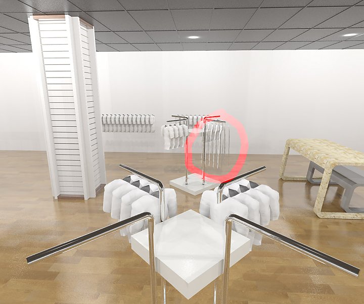

herdy1212 Posted December 9, 2009 Share Posted December 9, 2009 Hi all, back again! =D in the attached image i have added clothing into my scene and in the red ring which i have added in is a set of jeans except the jeans arent rendering complete. You can see the shirts are fine but the jeans are coming out looking like part of them are missing. I have done the same steps involved that i took for creating the shirt. Anyone know why this has happened? Quote Link to comment Share on other sites More sharing options...

Cad64 Posted December 9, 2009 Share Posted December 9, 2009 Ok, I've moved your thread to the Max section. I'm just guessing, but could it be that your Normals are flipped? Quote Link to comment Share on other sites More sharing options...
nocturne00 Posted December 10, 2009 Share Posted December 10, 2009 just a guess, Try to check on your cloth material if it is toggled as 2 sided. Quote Link to comment Share on other sites More sharing options...
