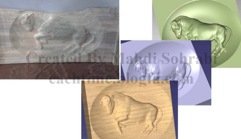

Hello.
I can suggest you "Geomagic Studio", professional reverse engineering software. use it beside CAD Software like CATIA. real fine result obtain if having enough skill.
See the Image of an conversion (better to say "Creating Surface" instead of "Conversion").

Well the original question is quite old, but I think it is worth stating that you cannot go from a polygonal format (known as a VisRep format) like OBJ to a CAD format (known as a Brep format) with any normal CAD software. None of the major CAD solutions will do it, nor will the various translators. The reason is that the true design information has been lost, and now you are dealing with just a polygon shell; it has no intelligence about what it is, in terms of cylindrical surfaces or planes. It is like a dumb piece of clay.
However, Mahdi did suggest Geomagic and I believe Geomagic can do it because they are built upon turning scans into CAD geometry, there are high-level algorithms necessary to infer CAD geometry, but keep in mind it is a guess, the resulting geometry will be an approximation.
