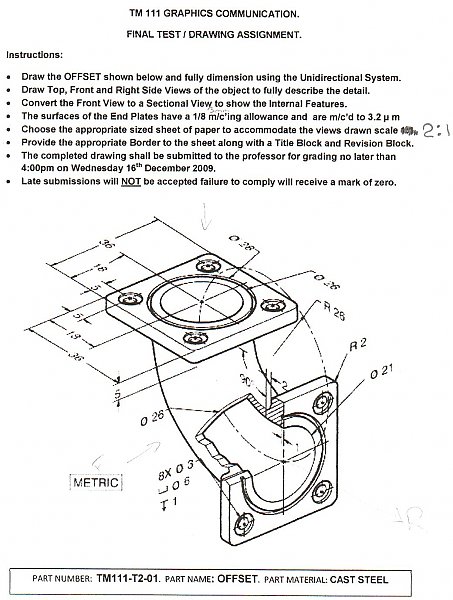

AAAKings Posted December 8, 2009 Posted December 8, 2009 So I will start off. I am in my first year of college to be an aerospace engineer. For our final test this semester for drafting, we must do the three views for this 3-d object. I think I got it but with it being worth 40% of my final makr, I want it to be bang on. Attached is a picture of the assignment. The second thing is my drawing of it. I know I need to scale it still But other than that, critisicm would be greatly appreciated. Pipe.dwg Quote

AAAKings Posted December 8, 2009 Author Posted December 8, 2009 It is supposed to be 2-D. The Front, Right, And Top view. He gave us that sheet and told us to go at it. I realized i forgot to Section it, but I don't want to do that until I got the outside done properly. I appreciate the criticism, but could you be a bit more specific in to which I need to edit? P.S. Only reason we are doing this to 2:1 is because we need to draw it by hand and the larger it is the easier. (First year, taught nothing) Quote

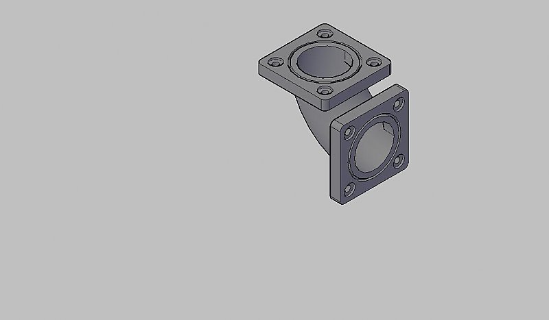

ReMark Posted December 9, 2009 Posted December 9, 2009 This is a "rough" approximation of the elbow done as a solid. I say rough because my eyesight isn't all that good. I may have misread a dimension or two. AutoCAD has the ability to extract the 2D views from this 3D object using the commands I mentioned in my previous post. No further drafting would be required other than adding dimensions and notes. Quote
AAAKings Posted December 9, 2009 Author Posted December 9, 2009 WOW. That looks amazing. I agree I should have said something earlier, but we as a class are going to speak to the dean about this teacher. How hard would it be to learn how to draw it in 3-d and then extract? Are there any good tutorials? Quote
ReMark Posted December 9, 2009 Posted December 9, 2009 Like I said it is "rough" but thanks just the same. The commands you would have to become familiar with to produce something akin to what is shown above are: Extrude (or Sweep), Subtract and Union. I also used the Region command. You would also have to know how to manipulate the UCS. We've already touched upon the commands for generating the 2D geometry. However, their use woud require further instruction. You'll find some 3D tutorials here as well as at other AutoCAD-related websites. A good after-market AutoCAD book wouldn't hurt either as the AutoCAD User's Guide is written more from a programmer's point of view than someone who actually uses AutoCAD day in and day out. It appears you have about a week to complete the task. It might be doable with the right help. Where are you located? Gotta go now. It has been a long day for me. I'll check this thread again in the morning. Quote

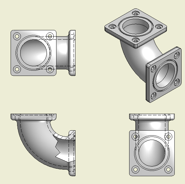

AAAKings Posted December 9, 2009 Author Posted December 9, 2009 I found an amazing tutorial and finished my 3-D view. Its 2:1 scal as requested and criticism is definetly appreciated. I am looking for a tutorial on how to section and make it 2-D. I can't seem to attach it, but It is available for download at http://www.filefactory.com/file/a1hgf2f/n/3-D_Flange.dwg . Quote

ReMark Posted December 9, 2009 Posted December 9, 2009 TripleA: I could not download your file. What's the secret? Glad to hear you have made some progress especially considering it is in 3D. Way to go! The three most common methods of producing 2D content from a 3D object are: 1) Flatshot 2) SolProf 3) The comination of SolView and SolDraw (used in that specific order) Quote
ReMark Posted December 9, 2009 Posted December 9, 2009 Flatshot: Creates a 2D flat block of a 3D model. SolProf: Creates a snapshot of a 3D object through a viewport. It uses the viewport as a reference points creating a 2D block from this view. SolView: Sets up the views of the 3D object (front, side, top, section, etc.). SolDraw: Draws the 2D entities of the 3D objects. SolView and SolDraw work together to produce a final product. Read up on each method then decide for yourself which way you want to proceed. Quote
