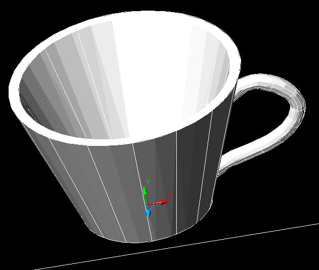

now im not bad in 3d modeling using 2010 autocad, but i stell need your help
i need to know how to draw the handle of such a cup of tea
i had draw the cup but i failed in its handle any one could help me

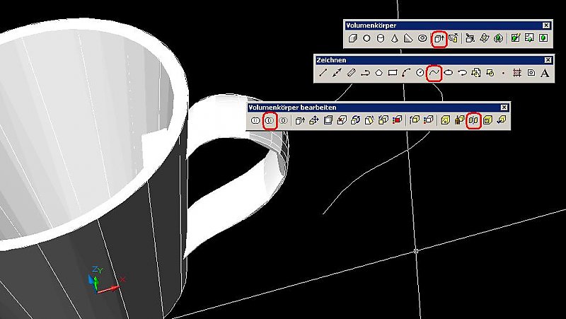

Handle:
I guess you made your cup creating a 3DSOLID using the ROTATE command from a spline or polyline.
Go to side view.
Draw a spline according to the shape of the handle. It should intersect with your cup, so that both ends of the spline are well inside the cup.
Go to 3D View. Go to WCS (World Coordinate System).
Draw a CIRCLE or an ELLIPSE with the center at one end of your spline as the profile of your handle. Don't care for the orientation.
Click the EXTRUSION button from the 3D TOOLBOX.
Click your CIRCLE.
Choose the option [PATH]
Click on your SPLINE.
You should see your handle now. Use different SHADE MODES.
But the ends of the handle are visible inside the cup.
COPY the cup without moving.
SUBTRACT the cup from the handle.
SEPARATE the handle (not sure about the english name of the command - you find it in the MODIFY 3D SOLIDS TOOLBOX. The symbol is '2 little cubes with a dashed line inbetween' next to the button with the broom.)
DELETE the inside parts.
You're done. Inshallah you'll be succesful.
