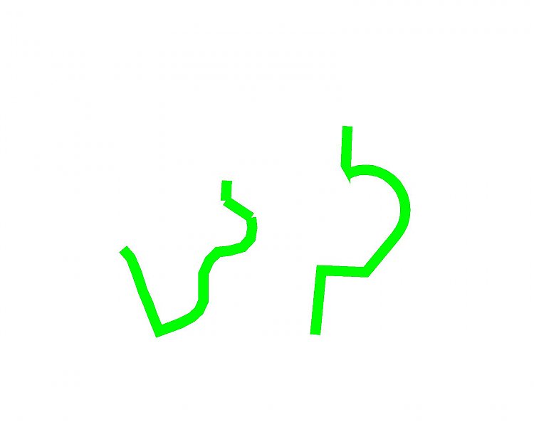

Hi,
Was difficult to explain so please see attached.
Is there a setting so that where the segments connect, it's shown smoother, without doing a spline? I'm stumped. :?
Thanks
zoom out, and draw longer lines.
It's like you're looking at the spline through a microscope.
From what I can see is that you have the end points to the lines set incorrectly. May try a circular end of line type.
Or the polyline is not continuous. It is a bunch of polyline segments all near to one another. The ones on the righthand image look to be connected, but those on the left do not look so.
Wm.
try these...
make sure the plinegen command is set to one
and your psltscale is set to one
your ltscale of the polyline is on
the line should be continuous
make sure the polyline is joined
lastly, try the command gr ....and the options window opens...
select display
mouse over to display resolution
...below are my settings...
10000 arc and circle smoothness
8 segments in a polyline curve
1 object smoothness
4 lines per surface
I don't know if that will help, I was just bouncing through the menu this morning and saw the resolution settings and thought of your spine.
