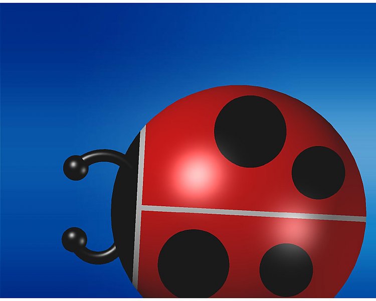

My problem is that my diagonal lines are often jagged (sometimes my arcs/circles are jagged as well). Here are some of the things I've tried thus far...
Viewres = 20,000
Segments in a polyline curve = 20,000
Rendered object smoothness = 9
Contour lines per surface = 1000
Computer & video card specs = more than adequate
When I plot the drawings, the jagged lines are unchaged (see below).
WTF? Please help.

When the lines are vertical or horizontal, they're fine. In fact, the object in the picture was originally horizontal, and then I rotated it to a random angle.

Actually, I'm just plotting it, not rendering it (plotted to .jpeg). I'm not that experienced (yet) on rendering. But I did try to render it once, and the ladybug looked fine. However, I had a new set of problems that I had deal with (i.e. in addition to the ladybugs, I have transparent colored bubbles. But when I render the drawing, the bubbles become non-transparent, but this does not happen if I plot straight to .jpeg file).

Don't plot to JPG, try BMP since it's a higher quality output. JPG is compressed. Use a 3rd party software to manipulate and compress the image. This might yield better results.
I wonder if you are seeing the old "Multi-stroke" lines. Based back in the days of pen plotters when using the minimum widths, or some sort of Single Pen system. It would build up a width to some polyline, via adding a bit of ink to the edges to make up for the defficiency.
I use color = system now. It then says if color 5 (as an example) is chosen the plot line widthit then set to .029" wide and with linetype of center2. Once you get used to it, then it goes, goes, goes, and eliminates the jagged edges.

After tweaking some of the plot settings, I was able to make it look a little better.
