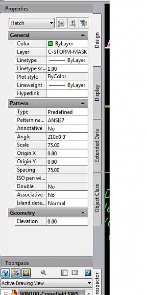

I'm trying to get the area of a particular hatch, but I don't see the area in the properties window. Does anyone know why "Area" isn't showing in my properties window. I've attached a screen shot of my properties window after selecting the hatch.
I'm using Autocad 2009....
Thanks,
kc

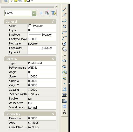

Hmm, I just tried that on my computer at home (Acad 2006), and I tried making hatch that was not associative, but I was able to still see the area in the properties window (I'll attach a screen shot of this). So, I don't think associativity is the cause of this. Any other suggestions as to why the hatch in ACAD Civil 3d 2009 didn't display the area in the properties window for me?
Thanks for any help.
kc

I've seen it before. It may have to do with the hatch boundary used to define the hatch actually has some glitches, like crossing lines or overlapping segment.
just hatchedit (HE) the object, recreate the boundary, then pick the created pline with "area" "object". come to think of it, i'm pretty sure you can just area object and pick the hatch entity itself and have it return the area in square feet. don't have access to cad right now to test though.
go here: http://www.jtbworld.com
he has a routine posted called "hatchb.lsp" that will create the boundary (closed pline) of a picked hatch entity.
That's a neat lisp. Up until now, I had to recreate the boundaries and join the line segments to form a polyline.
The problem is that my specific hatch has several pieces, so I would need to click on each polyline seperately and add up the areas manually.
I suppose I could re-create the hatch with those created polylines from the lisp and then see if it displays the area. I actually wasn't the one who created the hatch in the first place, so I just wish there was a way to have it show the area in the properties window. I appreciate all your help. Let me know if you can think of another way to try.
