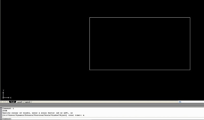

Hello all! I am getting fimilar with lisp now and would like to know if anyone could give me insite to creating a lisp that would basically trim or fillet corners within an area chosen.
Start with this: picture 1
and the output to look picture 2
Thanks!

If you want your lisp to do all the intersections in one go, you could use SSGET with the "I" implied mode, to get all the lines which you had previously selected (with PICKFIRST on). Then it's a matter of writing a loop to check each line against the others and find the intersections (with INTERS). Within that loop, every time you have an intersection you could call the FILLET command with a zero radius to get a double trim. This is one approach among many. Enjoy.
I was thinking something along the same lines as Randy...
For your example drawing you could accomplish this because for each line there is only two intersections. What about if there is more than two (ie your overall group is not a square)? You'd have to introduce conditions like only intersections within a certain distance from either end. I'd say if you are learning lisp you are biting into a pretty big chunk..
Thanks for the insite guys ... i am looking to just use this for rectangular areas. I'm still a newbie to the whole lisp/macro thing in autocad so i have my work cut out for me. Thanks!
If you are looking to proceed with the fillet method (zero radius), then you would need to work out a way to know which lines in the selection set need to be filleted with which.
As, if you just iterate through the selectionset filleting all the lines with each other, you could get undesired fillets.
Please try this:

The above yields undesirable results if the lines in question are not parallel/perpendicular. :wink:
That works just like i wanted it too! Thanks! :D
