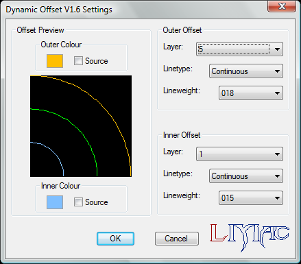

  • Offset Settings: Destination Layer/Linetype/LineWeight and Colour can be changed by pressing 'S'.

Offset Settings:
