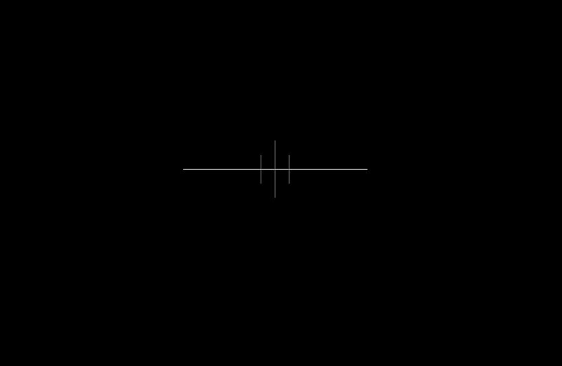

Ivan006 Posted November 23, 2009 Posted November 23, 2009 Is there a way to create a block that could trim a line when you insert it? The block I'm using is not rectangular, so to create a wipeout for this block would only mess it up. I know could just click the 2 ends of the lines and trim what's in between, but I have many of these blocks to insert, and having to avoid this step would save a lot of time. I don't know if this feature is on the new version of AutoCAD, but I'm running AutoCAD 2008. Any suggestions? Quote

Lee Mac Posted November 27, 2009 Posted November 27, 2009 This should work for most blocks: [i][color=#990099];; Auto Block Break by Lee McDonnell ~ 27.11.2009[/color][/i] [i][color=#990099];; Will Break Object by Rectangular Block Width at 0 Rotation.[/color][/i] [b][color=RED]([/color][/b][b][color=BLUE]defun[/color][/b] c:ins [b][color=RED]([/color][/b][b][color=BLUE]/[/color][/b] *error* doc spc vl ov bNme pt uFlag Obj ent Minp Maxp lst dis ang[b][color=RED])[/color][/b] [b][color=Red]([/color][color=Blue]vl-load-com[/color][color=Red])[/color][/b] [b][color=RED]([/color][/b][b][color=BLUE]defun[/color][/b] *error* [b][color=RED]([/color][/b]msg[b][color=RED])[/color][/b] [b][color=RED]([/color][/b][b][color=BLUE]and[/color][/b] uFlag [b][color=RED]([/color][/b][b][color=BLUE]vla-EndUndoMark[/color][/b] doc[b][color=RED])[/color][/b][b][color=RED])[/color][/b] [b][color=RED]([/color][/b][b][color=BLUE]and[/color][/b] ov [b][color=RED]([/color][/b][b][color=BLUE]mapcar[/color][/b] [b][color=DARKRED]'[/color][/b][b][color=BLUE]setvar[/color][/b] vl ov[b][color=RED])[/color][/b][b][color=RED])[/color][/b] [b][color=RED]([/color][/b][b][color=BLUE]or[/color][/b] [b][color=RED]([/color][/b][b][color=BLUE]wcmatch[/color][/b] [b][color=RED]([/color][/b][b][color=BLUE]strcase[/color][/b] msg[b][color=RED])[/color][/b] [b][color=#ff00ff]"*BREAK,*CANCEL*,*EXIT*"[/color][/b][b][color=RED])[/color][/b] [b][color=RED]([/color][/b][b][color=BLUE]princ[/color][/b] [b][color=RED]([/color][/b][b][color=BLUE]strcat[/color][/b] [b][color=#ff00ff]"\n** Error: "[/color][/b] msg [b][color=#ff00ff]" **"[/color][/b][b][color=RED])[/color][/b][b][color=RED])[/color][/b][b][color=RED])[/color][/b] [b][color=RED]([/color][/b][b][color=BLUE]princ[/color][/b][b][color=RED])[/color][/b][b][color=RED])[/color][/b] [b][color=RED]([/color][/b][b][color=BLUE]setq[/color][/b] doc [b][color=RED]([/color][/b][b][color=BLUE]vla-get-ActiveDocument[/color][/b] [b][color=RED]([/color][/b][b][color=BLUE]vlax-get-Acad-Object[/color][/b][b][color=RED])[/color][/b][b][color=RED])[/color][/b] spc [b][color=RED]([/color][/b][b][color=BLUE]if[/color][/b] [b][color=RED]([/color][/b][b][color=BLUE]zerop[/color][/b] [b][color=RED]([/color][/b][b][color=BLUE]vla-get-activespace[/color][/b] doc[b][color=RED])[/color][/b][b][color=RED])[/color][/b] [b][color=RED]([/color][/b][b][color=BLUE]if[/color][/b] [b][color=RED]([/color][/b][b][color=BLUE]=[/color][/b] [b][color=RED]([/color][/b][b][color=BLUE]vla-get-mspace[/color][/b] doc[b][color=RED])[/color][/b] [b][color=Blue]:vlax-true[/color][color=RED])[/color][/b] [b][color=RED]([/color][/b][b][color=BLUE]vla-get-modelspace[/color][/b] doc[b][color=RED])[/color][/b] [b][color=RED]([/color][/b][b][color=BLUE]vla-get-paperspace[/color][/b] doc[b][color=RED])[/color][/b][b][color=RED])[/color][/b] [b][color=RED]([/color][/b][b][color=BLUE]vla-get-modelspace[/color][/b] doc[b][color=RED])[/color][/b][b][color=RED])[/color][/b][b][color=RED])[/color][/b] [b][color=RED]([/color][/b][b][color=BLUE]setq[/color][/b] vl [b][color=DARKRED]'[/color][/b][b][color=RED]([/color][/b][b][color=#ff00ff]"CMDECHO"[/color][/b] [b][color=#ff00ff]"OSMODE"[/color][/b][b][color=RED])[/color][/b] ov [b][color=RED]([/color][/b][b][color=BLUE]mapcar[/color][/b] [b][color=DARKRED]'[/color][/b][b][color=BLUE]getvar[/color][/b] vl[b][color=RED])[/color][/b][b][color=RED])[/color][/b] [b][color=RED]([/color][/b][b][color=BLUE]while[/color][/b] [b][color=RED]([/color][/b][b][color=BLUE]progn[/color][/b] [b][color=RED]([/color][/b][b][color=BLUE]setq[/color][/b] bNme [b][color=RED]([/color][/b][b][color=BLUE]getstring[/color][/b] [b][color=BLUE]t[/color][/b] [b][color=RED]([/color][/b][b][color=BLUE]strcat[/color][/b] [b][color=#ff00ff]"\nSpecify Block Name <"[/color][/b] [b][color=RED]([/color][/b][b][color=BLUE]getvar[/color][/b] [b][color=#ff00ff]"INSNAME"[/color][/b][b][color=RED])[/color][/b] [b][color=#ff00ff]"> : "[/color][/b][b][color=RED])[/color][/b][b][color=RED])[/color][/b][b][color=RED])[/color][/b] [b][color=RED]([/color][/b][b][color=BLUE]cond[/color][/b] [b][color=RED]([/color][/b] [b][color=RED]([/color][/b][b][color=BLUE]eq[/color][/b] [b][color=#ff00ff]""[/color][/b] bNme[b][color=RED])[/color][/b] [b][color=RED]([/color][/b][b][color=BLUE]setq[/color][/b] bNme [b][color=RED]([/color][/b][b][color=BLUE]getvar[/color][/b] [b][color=#ff00ff]"INSNAME"[/color][/b][b][color=RED])[/color][/b][b][color=RED])[/color][/b] [b][color=BLUE]nil[/color][/b][b][color=RED])[/color][/b] [b][color=RED]([/color][/b] [b][color=RED]([/color][/b][b][color=BLUE]and[/color][/b] [b][color=RED]([/color][/b][b][color=BLUE]snvalid[/color][/b] bNme[b][color=RED])[/color][/b] [b][color=RED]([/color][/b][b][color=BLUE]or[/color][/b] [b][color=RED]([/color][/b][b][color=BLUE]tblsearch[/color][/b] [b][color=#ff00ff]"BLOCK"[/color][/b] bNme[b][color=RED])[/color][/b] [b][color=RED]([/color][/b][b][color=BLUE]setq[/color][/b] bNme [b][color=RED]([/color][/b][b][color=BLUE]findfile[/color][/b] [b][color=RED]([/color][/b][b][color=BLUE]strcat[/color][/b] bNme [b][color=#ff00ff]".dwg"[/color][/b][b][color=RED])[/color][/b][b][color=RED])[/color][/b][b][color=RED])[/color][/b][b][color=RED])[/color][/b][b][color=RED])[/color][/b] [b][color=BLUE]nil[/color][/b][b][color=RED])[/color][/b] [b][color=RED]([/color][/b][b][color=BLUE]t[/color][/b] [b][color=RED]([/color][/b][b][color=BLUE]princ[/color][/b] [b][color=#ff00ff]"\n** Block not Found **"[/color][/b][b][color=RED])[/color][/b][b][color=RED])[/color][/b][b][color=RED])[/color][/b][b][color=RED])[/color][/b][b][color=RED])[/color][/b] [b][color=RED]([/color][/b][b][color=BLUE]if[/color][/b] [b][color=RED]([/color][/b][b][color=BLUE]setq[/color][/b] pt [b][color=RED]([/color][/b][b][color=BLUE]getpoint[/color][/b] [b][color=#ff00ff]"\nSelect Point for Block: "[/color][/b][b][color=RED])[/color][/b][b][color=RED])[/color][/b] [b][color=RED]([/color][/b][b][color=BLUE]progn[/color][/b] [b][color=RED]([/color][/b][b][color=BLUE]setq[/color][/b] uFlag [b][color=RED]([/color][/b][b][color=BLUE]not[/color][/b] [b][color=RED]([/color][/b][b][color=BLUE]vla-StartUndoMark[/color][/b] doc[b][color=RED])[/color][/b][b][color=RED])[/color][/b] Obj [b][color=RED]([/color][/b][b][color=BLUE]vla-InsertBlock[/color][/b] spc [b][color=RED]([/color][/b][b][color=BLUE]vlax-3D-point[/color][/b] pt[b][color=RED])[/color][/b] bNme [b][color=#009999]1.[/color][/b] [b][color=#009999]1.[/color][/b] [b][color=#009999]1.[/color][/b] [b][color=#009999]0.[/color][/b][b][color=RED])[/color][/b][b][color=RED])[/color][/b] [b][color=RED]([/color][/b][b][color=BLUE]setvar[/color][/b] [b][color=#ff00ff]"INSNAME"[/color][/b] bNme[b][color=RED])[/color][/b] [b][color=RED]([/color][/b][b][color=BLUE]if[/color][/b] [b][color=RED]([/color][/b][b][color=BLUE]and[/color][/b] [b][color=RED]([/color][/b][b][color=BLUE]setq[/color][/b] ent [b][color=RED]([/color][/b][b][color=BLUE]car[/color][/b] [b][color=RED]([/color][/b][b][color=BLUE]nentselp[/color][/b] pt[b][color=RED])[/color][/b][b][color=RED])[/color][/b][b][color=RED])[/color][/b] [b][color=RED]([/color][/b][b][color=BLUE]not[/color][/b] [b][color=RED]([/color][/b][b][color=BLUE]vl-catch-all-error-p[/color][/b] [b][color=RED]([/color][/b][b][color=BLUE]vl-catch-all-apply[/color][/b] [b][color=DARKRED]'[/color][/b][b][color=BLUE]vlax-curve-getEndParam[/color][/b] [b][color=RED]([/color][/b][b][color=BLUE]list[/color][/b] ent[b][color=RED])[/color][/b][b][color=RED])[/color][/b][b][color=RED])[/color][/b][b][color=RED])[/color][/b][b][color=RED])[/color][/b] [b][color=RED]([/color][/b][b][color=BLUE]progn[/color][/b] [b][color=RED]([/color][/b][b][color=BLUE]setq[/color][/b] pt [b][color=RED]([/color][/b][b][color=BLUE]vlax-curve-getClosestPointto[/color][/b] ent pt[b][color=RED])[/color][/b][b][color=RED])[/color][/b] [b][color=RED]([/color][/b][b][color=BLUE]vla-getBoundingBox[/color][/b] Obj [b][color=DARKRED]'[/color][/b]Minp [b][color=DARKRED]'[/color][/b]Maxp[b][color=RED])[/color][/b] [b][color=RED]([/color][/b][b][color=BLUE]setq[/color][/b] lst [b][color=RED]([/color][/b][b][color=BLUE]mapcar[/color][/b] [b][color=DARKRED]'[/color][/b][b][color=BLUE]vlax-safearray->list[/color][/b] [b][color=RED]([/color][/b][b][color=BLUE]list[/color][/b] Minp Maxp[b][color=RED])[/color][/b][b][color=RED])[/color][/b] dis [b][color=RED]([/color][/b][b][color=BLUE]-[/color][/b] [b][color=RED]([/color][/b][b][color=BLUE]caadr[/color][/b] lst[b][color=RED])[/color][/b] [b][color=RED]([/color][/b][b][color=BLUE]caar[/color][/b] lst[b][color=RED])[/color][/b][b][color=RED])[/color][/b][b][color=RED])[/color][/b] [b][color=RED]([/color][/b][b][color=BLUE]vla-put-Rotation[/color][/b] Obj [b][color=RED]([/color][/b][b][color=BLUE]setq[/color][/b] ang [b][color=RED]([/color][/b][b][color=BLUE]angle[/color][/b] [b][color=DARKRED]'[/color][/b][b][color=RED]([/color][/b][b][color=#009900]0[/color][/b] [b][color=#009900]0[/color][/b] [b][color=#009900]0[/color][/b][b][color=RED])[/color][/b] [b][color=RED]([/color][/b][b][color=BLUE]vlax-curve-getFirstDeriv[/color][/b] ent [b][color=RED]([/color][/b][b][color=BLUE]vlax-curve-getParamatPoint[/color][/b] ent pt[b][color=RED])[/color][/b][b][color=RED])[/color][/b][b][color=RED])[/color][/b][b][color=RED])[/color][/b][b][color=RED])[/color][/b] [b][color=RED]([/color][/b][b][color=BLUE]mapcar[/color][/b] [b][color=DARKRED]'[/color][/b][b][color=BLUE]setvar[/color][/b] vl [b][color=DARKRED]'[/color][/b][b][color=RED]([/color][/b][b][color=#009900]0[/color][/b] [b][color=#009900]0[/color][/b][b][color=RED])[/color][/b][b][color=RED])[/color][/b] [b][color=RED]([/color][/b][b][color=BLUE]command[/color][/b] [b][color=#ff00ff]"_.break"[/color][/b] [b][color=RED]([/color][/b][b][color=BLUE]list[/color][/b] ent pt[b][color=RED])[/color][/b] [b][color=#ff00ff]"_F"[/color][/b] [b][color=RED]([/color][/b][b][color=BLUE]osnap[/color][/b] [b][color=RED]([/color][/b][b][color=BLUE]polar[/color][/b] pt ang [b][color=RED]([/color][/b][b][color=BLUE]/[/color][/b] dis [b][color=#009999]2.[/color][/b][b][color=RED])[/color][/b][b][color=RED])[/color][/b] [b][color=#ff00ff]"_nea"[/color][/b][b][color=RED])[/color][/b] [b][color=RED]([/color][/b][b][color=BLUE]osnap[/color][/b] [b][color=RED]([/color][/b][b][color=BLUE]polar[/color][/b] pt ang [b][color=RED]([/color][/b][b][color=BLUE]/[/color][/b] dis [b][color=#009999]-2.[/color][/b][b][color=RED])[/color][/b][b][color=RED])[/color][/b] [b][color=#ff00ff]"_nea"[/color][/b][b][color=RED])[/color][/b][b][color=RED])[/color][/b] [b][color=RED]([/color][/b][b][color=BLUE]mapcar[/color][/b] [b][color=DARKRED]'[/color][/b][b][color=BLUE]setvar[/color][/b] vl ov[b][color=RED])[/color][/b][b][color=RED])[/color][/b][b][color=RED])[/color][/b] [b][color=RED]([/color][/b][b][color=BLUE]setq[/color][/b] uFlag [b][color=RED]([/color][/b][b][color=BLUE]vla-EndUndomark[/color][/b] doc[b][color=RED])[/color][/b][b][color=RED])[/color][/b][b][color=RED])[/color][/b][b][color=RED])[/color][/b] [b][color=RED]([/color][/b][b][color=BLUE]princ[/color][/b][b][color=RED])[/color][/b][b][color=RED])[/color][/b] Quote

Lee Mac Posted December 2, 2009 Posted December 2, 2009 Yes, its not a big one, it just means the Visual LISP console isn't loaded. Most people (me included) have (vl-load-com) in their ACADDOC.lsp and so don't realise if (vl-load-com) is missing from code. I have updated my code in my previous post, it should work now. Quote
Ivan006 Posted December 2, 2009 Author Posted December 2, 2009 I have updated my code in my previous post, it should work now. Thanks Lee Mac. It works now. I'm going to use this lisp for now to finish my job, but I was wondering for the future, could this lisp have the option of browsing for other blocks? Also, I don't know if there is a fourm that explains how to do this, but is there any way to create a button that loads the lisp? Thanks again, Ivan8) Quote
Lee Mac Posted December 2, 2009 Posted December 2, 2009 Thanks Lee Mac. It works now. Excellent - good to hear. I'm going to use this lisp for now to finish my job, but I was wondering for the future, could this lisp have the option of browsing for other blocks? The LISP should work for most blocks - (assuming they don't have any protruding features). Also, I don't know if there is a fourm that explains how to do this, but is there any way to create a button that loads the lisp? To automatically load the LISP on startup, you can either add it to the Startup Suite on the appload dialog. Or, alternatively, you can create an ACADDOC.lsp in your ACAD search path and put a call, like this in it: (load "ins.lsp" "Load Failed") More info here: Auto-Loading LISP (ACADDOC.lsp etc): http://www.theswamp.org/index.php?topic=30946.msg364983#msg364983 http://www.cadtutor.net/faq/questions/53/How+do+I+automatically+load+variables%3F To call the LISP from a button, create a new button, and in the Macro Box put this: ^C^C(c:ins) Quote
brybigdog Posted May 18, 2010 Posted May 18, 2010 Lee Mac, I tried your code and it does work but it doesn't trim the lines to the edge of the block. Some blocks work correctly some don't. I would like to use this to create a custom toolbar to place P&ID symbols. Is it possible to alter the code to work something like this for a button macro... Button macro -start ins command -specify block name for button -total length of line break ^C^Cc:ins;block_name.dwg;###; Also could you add a way to search a specific directory if the block isn't in the current drawing? I'm trying to figure this stuff out on my own but my knowledge of code is limited. Any help would be greatly appreciated. Thanks Quote
Lee Mac Posted May 18, 2010 Posted May 18, 2010 Hi, The code assumes a central base point and calculates the trim points using the rectangular size of the block, so it may not be suitable for all blocks... Quote
