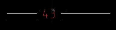

satdog Posted September 10, 2010 Share Posted September 10, 2010 Hello ! In "Dynamically Align text to Curve" can I change the size of the backgroundmask, I have tried but cant find where in your code. (I have two parallel lines and when i put a text in the line above the backgroundmask reachs the line belove) Thanks Anders Quote Link to comment Share on other sites More sharing options...
Lee Mac Posted September 10, 2010 Author Share Posted September 10, 2010 Hi Anders, The background mask would be that which is created should you switch it on manually for the MText object, i.e. its size is controlled by the Mtext object. Lee Quote Link to comment Share on other sites More sharing options...
alanjt Posted September 10, 2010 Share Posted September 10, 2010 Hi Anders, The background mask would be that which is created should you switch it on manually for the MText object, i.e. its size is controlled by the Mtext object. Lee I think he's referring to the BackGround offset. Quote Link to comment Share on other sites More sharing options...
Lee Mac Posted September 10, 2010 Author Share Posted September 10, 2010 I think he's referring to the BackGround offset. Ah right - in that case, it will just use the default background mask settings. Quote Link to comment Share on other sites More sharing options...
alanjt Posted September 10, 2010 Share Posted September 10, 2010 Ah right - in that case, it will just use the default background mask settings. 1.5 Have you ever come across a way to change that? You can entmod it individually, but it would be nice to just set a default. Quote Link to comment Share on other sites More sharing options...
