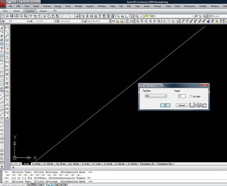

Ringis Posted December 1, 2009 Share Posted December 1, 2009 Hi again Lee Perfect option with style and height, but I have a problem when using it. Everytime I change the height to ex. height=300, it becomes = 1 when finishing the command. I have tried many times but the height remains 1 no matter what I type in. //Tobias Quote Link to comment Share on other sites More sharing options...
ectech Posted December 1, 2009 Share Posted December 1, 2009 Hi, I'm the beginner of the autolisp, I hope learning more more from you. Quote Link to comment Share on other sites More sharing options...
Lee Mac Posted December 1, 2009 Author Share Posted December 1, 2009 Hi again Lee Perfect option with style and height, but I have a problem when using it. Everytime I change the height to ex. height=300, it becomes = 1 when finishing the command. I have tried many times but the height remains 1 no matter what I type in. //Tobias This may happen if you are using an annotative text style - is this the case? Hi, I'm the beginner of the autolisp, I hope learning more more from you. Thanks, I hope you do Quote Link to comment Share on other sites More sharing options...
Ringis Posted December 1, 2009 Share Posted December 1, 2009 This may happen if you are using an annotative text style - is this the case? Nope, I never use annotative text style. //Tobias Quote Link to comment Share on other sites More sharing options...
Lee Mac Posted December 1, 2009 Author Share Posted December 1, 2009 I shall look into it Ringis - thanks Quote Link to comment Share on other sites More sharing options...
Ringis Posted December 1, 2009 Share Posted December 1, 2009 I tried some more: Even if i don´t change the height it jumps to height =1 Se the images, after clicking ok with no changes to the height, it changes to 1 , the text is still there but of course not visible if you don´t zoom. Thanks again Lee, I´m using it often anyway, but if this option works it would be super! //Tobias Quote Link to comment Share on other sites More sharing options...
Lee Mac Posted December 1, 2009 Author Share Posted December 1, 2009 Thanks for the explanation Ringis, I should have some time tonight to look at it, will get back to you. Quote Link to comment Share on other sites More sharing options...
Lee Mac Posted December 2, 2009 Author Share Posted December 2, 2009 Hi Tobias, Many thanks for the bug report - there are always things that I miss... I have updated the code in the archive to Version 2.4 - this should hopefully resolve the issue. If you do find anything else untoward, please let me know! Thanks, Lee Quote Link to comment Share on other sites More sharing options...
