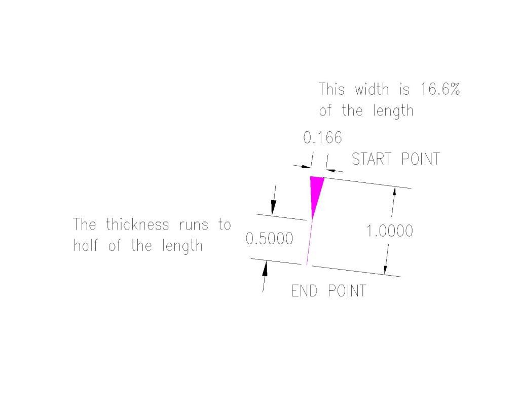

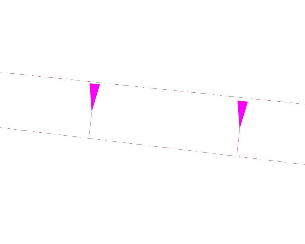

I have to draw alot of SLOPE arrows for land surveys. Like below (dashed lines are the bank , but it is the POLYLINE indicating the slope that I am interested in).
I would ulimtaely like to pick a START POINT on the bank (using nearest snap) and pick a point on the bottom of the bank END POINT.
A 3 point polyline would be produced where the width at the START POINT would be one sixth (16.66%) of the total length of the polyline.
If it was a LISP, I could right click and do another & another and so on.
See image below.
At the moment I do a 3 point line and edit after using PROPERTIES. It takes ages.
Please help a rookie.

OMG Lee Mac, thats amazing. :shock:
It works perfectly.
