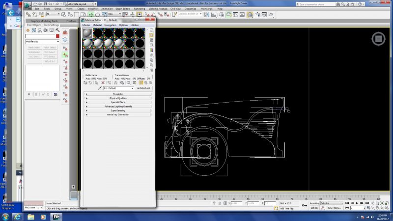

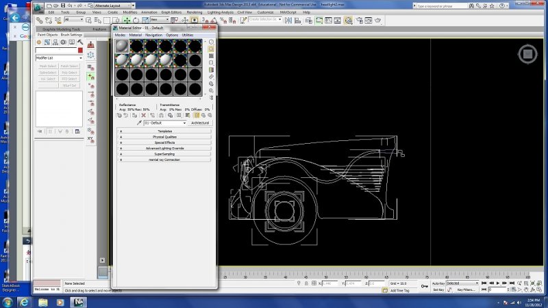

herdy1212 Posted November 20, 2009 Share Posted November 20, 2009 Is it possible to render a scene with only the wireframe visible? no lights no materials no solids just purely the wireframe of the model? thanks! Quote Link to comment Share on other sites More sharing options...

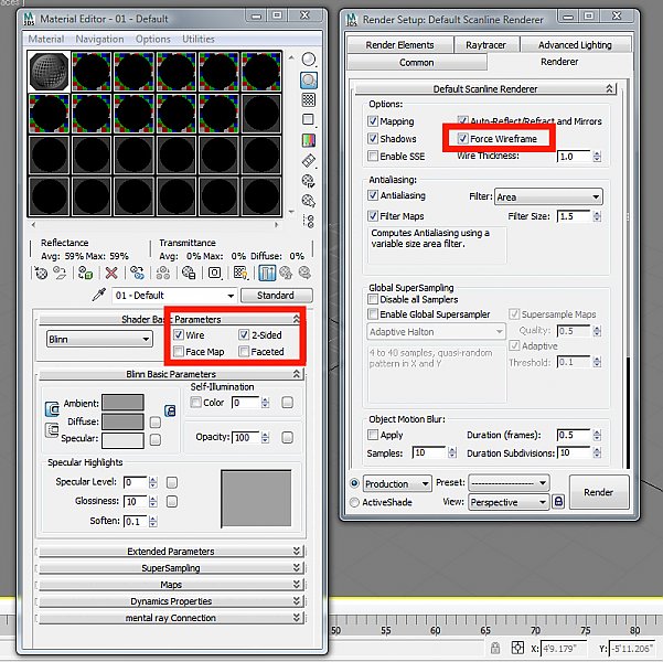

Cad64 Posted November 20, 2009 Share Posted November 20, 2009 Do you want to render just the wires or do you want to render your model with the wires visible on the surface? Here's a tutorial showing how to render your model with wires visible: http://www.eddybrown.co.uk/blog/claywireframerender/ If you want to render just the wires, Put a check in the "Wire" box of the material you have applied to your model. Also, check the "2-Sided" option. Then make sure you are using the "Scanline" renderer and put a check in the "Force Wireframe" box on the "Renderer" tab. Then hit render and you should get a Wireframe rendering of your model. Quote Link to comment Share on other sites More sharing options...

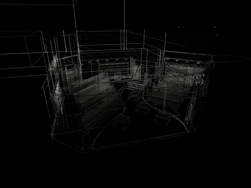

herdy1212 Posted November 20, 2009 Author Share Posted November 20, 2009 fantastic, thank you very much thats exactly what i was looking for. The 2nd of the explainations u gave. If i could go one step further though =D in my render u can see that the background is black and the wireframe is white (well semi white) is it possible to reverse this? and have a white background with a black wireframe? Quote Link to comment Share on other sites More sharing options...
Cad64 Posted November 20, 2009 Share Posted November 20, 2009 Yes, go to your "Rendering" pull down menu and click "Environment". In the "Environment and Effects" dialog, click the "Environment" tab. Under "Common Parameters" you can set the Background Color to whatever you want. Then just set your material color to black and hit Render. Quote Link to comment Share on other sites More sharing options...

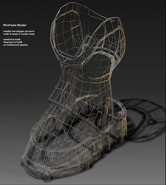

rocneasta Posted November 23, 2009 Share Posted November 23, 2009 speaking of wireframe rendering - this so far is pretty much clearcut, but i saw this reference on the internet and was wondering how did the author go about doing this Quote Link to comment Share on other sites More sharing options...
Cad64 Posted November 24, 2009 Share Posted November 24, 2009 You do it the same way I described above, except you throw a gradient map in your Environment map slot, add a light source, (spot light), and then stick a flat plane under your model with a Matte/Shadow material applied to it. Oh, and you will have to disable "Force Wireframe" in your render settings. Quote Link to comment Share on other sites More sharing options...

cewilliams19 Posted November 28, 2012 Share Posted November 28, 2012 I can get the Material Editor up, but I do not see those areas to be checked. Is there anywhere else I can find those or am I just applying a wrong Material. Possibly our virsions are different and they are now located in a different area. Quote Link to comment Share on other sites More sharing options...
Cad64 Posted November 28, 2012 Share Posted November 28, 2012 Sorry but I don't use Studio Max anymore, and the last version I used was 2011. Hopefully someone else will come along with a solution for you. Quote Link to comment Share on other sites More sharing options...
