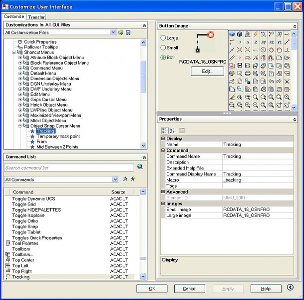

I have found out that I can type in the "Tracking" or "TK" or "Track" command in the command window after involking a Line or point command and it will work, but I would like to get that into the shortcut menu just above Temporary Track Point. Does anyone know what the Properties of this command are?
I cannot find Tracking in the command list in the CUI. I can make a custom command but I dont know all the properties to make it work.
Figured it out, now I can make a contribution to the forum.
For those who use the older Tracking command from the shortcut menu and miss the inclusion in LT2004 and up you can add it in the CUI by making a custom command and naming it Tracking and putting “_tracking” next to the Macro space in Properties, then add by dragging to the CUI “Shortcut Menus/Object Snap Cursor Menu”
Screen shot below to help.
Please send AutoDe$k a big "thank you" for screwing things up. It seems some geek programmer gets to decide what is and isn't useful in the "real world". Go figure.
Thank you for sharing the fix with us.

Although the 2008 user guide says that tracking is available on the shift right-click menu, it is not avaialble. It has to be added as pointed out above

Thank you Kingdaddy!!! So happy I have that command on my shortcut menu now. I did add it to 2008 back when, but I forgot how. Upgraded to 2012 and was really missing it. I am all set now--at least with this issue. Need to set up plots and pen assignments tomorrow. Ugh.
