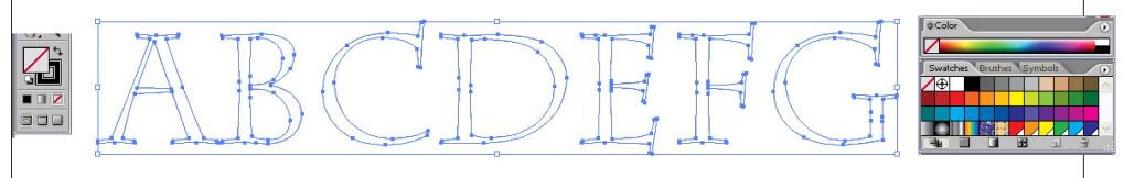

1. Create your text in Illustrator. You can use any style or font that you want to use. You can also use any other vector style image, such as company logos, clip-art or what ever you create.
2. Outline your text. Outlining your text in Illustrator is the equivleant of exploding your text in Auto CAD. This allows it so that you can modify your text as well. See the attached image.
3. Create a pen outline for your image. All that is done here is making the fill color transparent and the outline what ever color you see fit. If you skip this part, and import to Auto CAD, you will be unable to modify or use the outline. See attached image.

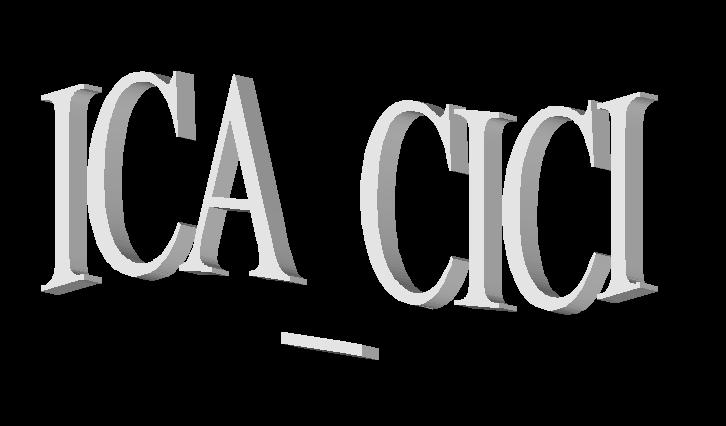

Trying the word Art option, it's pretty cute and no need to scale by 25.4 any more with txtexp command.:)
