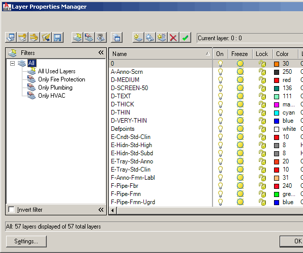

i imported a dwg into a dwt. but now some of my linework & hatch are on the same layer as my gEarth raster. I want to move them to their own new layer (so I can manipulate them in 3D). However, everytime i try to create a new layer in the L. Manager, i get the error msg, "New Layer Created Does Not Match Current Layer File". well, so what? i tried turning off my current layer file & that didn't help. ok-- thx. all. (i'm using Help, searching this site & trying not to post too much stuff)

whoops. very sorry. i'm pretty tired from days of working on this stuff. appreciate your tenacity, buzz. ok. so what it Really says (& it was a good catch) is: "A new layer was created that does not match current filter". & little Layer 1 & 2 & 3 Laugh @ me from the the layer Properties Mgr box until i click the error msg & then each stinking new Layer disappears in turn like drunk teenagers hurling mudballs on Halloween when i close the error msg. not sure how to send a screenshot right now b/c my screenshot gizmo busted. tried to paste it here...wa wa wa. well, thx. again!
No sweat - verify that your layer filter is set to "All"
