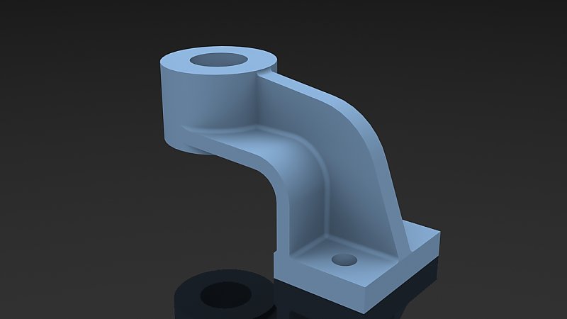

ReMark Posted November 17, 2009 Posted November 17, 2009 JDM drew the object using a height of 120 and an angle of 70 if I'm not mistaken (please correct me if I am wrong). His drawing looks like the object in your image. At a height of 120 the 70 degree angle appears to work. If the height is pushed to 157 then I believe the angle would have to be greater than 70 degrees. That is how I perceive it. Quote

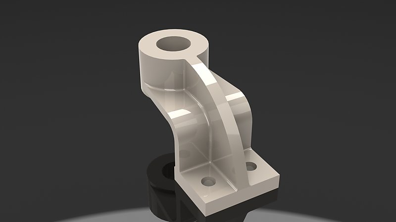

lulumara Posted November 18, 2009 Posted November 18, 2009 here's my final rendering of CUTE ENG's assignment : Bearing housing made in Solidworks Quote
ReMark Posted November 18, 2009 Posted November 18, 2009 Nice image but I think the geometry is slightly off. That ridge that runs from the top of the base up to the top of the circle isn't supposed to be an arc. It actually has a 70 angle to it. What made you change it? Quote
lulumara Posted November 18, 2009 Posted November 18, 2009 That angle of 70 degrees is still there, I did a straight line from circle to intersection of the line of 70 degrees, it will not connect the top ridge of the circle thru the 70 degrees ridge then fillet the intersection. Quote

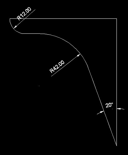

Glen Smith Posted November 18, 2009 Posted November 18, 2009 Lulumara, I like your arc better than the way it was drawn. While fiddling with it this am I used this. I tried with the 2 radii tan. to each other but it didn't look right. Quote
JD Mather Posted November 18, 2009 Posted November 18, 2009 Glen Smith said: Lulumara, I like your arc better than the way it was drawn. Run an FEA anaylsis on various solutions. Quote

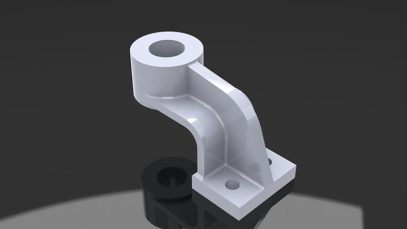

lulumara Posted November 18, 2009 Posted November 18, 2009 I'm back, it takes me for a while my computer freezes, I just updated my Antivirus it when freezing?? Oh I just revised my drawing as Remark just told me it's not an Arc , Sorry my fault. Quote
JD Mather Posted November 18, 2009 Posted November 18, 2009 Looks like the width of the L-shape is wrong too. I see offset of 6 (assume both sides for total width of 80 - same as cylinder. 92-(2*6)= 80 Not same as base. Quote
lulumara Posted November 18, 2009 Posted November 18, 2009 Ooppss I failed the Test, Getting older need some pair of eye glasses. I adjusted didn't even see that thanks. Quote
lulumara Posted November 18, 2009 Posted November 18, 2009 Glen Smith said: Lulumara, I like your arc better than the way it was drawn. While fiddling with it this am I used this. I tried with the 2 radii tan. to each other but it didn't look right. Hi Glen Smith , thanks for the compliment with the arc but it was wrong hehehhehe. Quote
