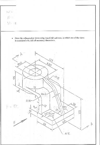

cute eng Posted November 17, 2009 Posted November 17, 2009 hi i want to be sure about hight width and depth i think w=153 h=175 d=92 it is right ?? and how can i draw the angle 70 ?? which i draw a circle around it and quastion mark ? Quote

JD Mather Posted November 17, 2009 Posted November 17, 2009 ReMark said: Yes...you are right. I'm not sure I make out the numbers, but I get 125+(60/2)+28=183 92 120 Quote

JD Mather Posted November 17, 2009 Posted November 17, 2009 cute eng said: how i make the angle 70 Just out of curiosity - how much instruction have you gottten on using CAD software? Did you professor just give these assignments without any formal instruction and expect you to figure it out on your own? There are many ways to create the 70° angle. My preference would be to simply create a vertical line and then rotate 20° rather than fool with the other methods. You can rotate by clicking the line and select the grip at the location of rotation center and right mouse button select rotate and then follow the command line prompts. This method seems to be the easiest for beginners. BTW - I think if I were just starting out learning CAD for mechanical type models like this I would learn one of the next generation CAD programs like Autodesk Inventor rather than AutoCAD. In Inventor you model like the real world part and then the software creates your orthographic projections for you. Students can download Inventor for free from http://www.autodesk.com/edcommunity (nearly 1 million members) and register to activate free 13-month license. Quote
cute eng Posted November 17, 2009 Author Posted November 17, 2009 JD Mather said: I'm not sure I make out the numbers, but I get125+(60/2)+28=183 92 120 ohh my god !!! i started and i finshed top view little bit i finish the front i think again and i get w=153 h=157 d=92 who can give me the right numbers ? Quote
JD Mather Posted November 17, 2009 Posted November 17, 2009 cute eng said: ...who can give me the right numbers ? Where is your professor in all of this process? This is simple math. Do my numbers add up or not (keep in mind that I can't be sure of your fuzzy scan). Quote
cute eng Posted November 17, 2009 Author Posted November 17, 2009 JD Mather said: Where is your professor in all of this process? This is simple math. Do my numbers add up or not (keep in mind that I can't be sure of your fuzzy scan). he didnt give us these number we shluld got it Quote

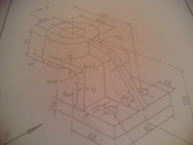

ReMark Posted November 17, 2009 Posted November 17, 2009 Is there any chance we can see a better scan? Even I'm having a bit of a problem reading the one provided. In the meantime, on the chance this image has been borrowed from a technical drawing book, I have three at my side I can reference. Perhaps I'll find the same drawing there. In the words of the Terminator...I'll be back. Quote

ReMark Posted November 17, 2009 Posted November 17, 2009 Thanks for the new image. I came up empty handed despite looking in my three best mechanical/technical drawing books. By the way, where are you located? What school are you attending? Quote
