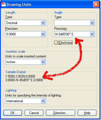

ReMark Posted November 16, 2009 Posted November 16, 2009 What is Angle > Type set to in Units? Probably Decimal, right? Change it. Quote
KevUK Posted November 16, 2009 Author Posted November 16, 2009 What is Angle > Type set to in Units? Probably Decimal, right? Change it. Units are set to DMS, Not decimal!! Quote

KevUK Posted November 16, 2009 Author Posted November 16, 2009 Seems to be some information missing in that sequence. What template did you start with or where did you set Units in that sequence? Create New Drawing Use Wizard Advanced Setup Decimal (Precision: 0.0000) Angle-Deg/Min/Sec (Precision: 0d00'00.00'') Direction for angle: North Orientation for angle: Clockwise Area: 420X297 Quote
