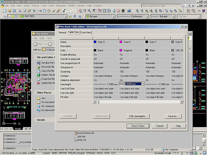

Hi
The jpeg will clear your doubts.
This is the plotstyle i usually use for my dwgs.
If you take a closer look on the "plot style table editor" dialog box you will notice the difference i ve made for colour no. 6. When printed it prints with colour & line weight more than other lines.
