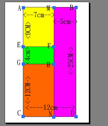

Last, I used PowerPoint to draw square,circle.
Powerpoint is very simple to set Output Paper Size (A4/A3) , draw square/circle size (cm),
sample to used keyboard to move that object right/left/upper/lower.
now changed to used AutoCAD, is very difference.
I very like features "dimlinear". but move that object is hard, can't used keyboard to move it.
This is used powerpoint to draw square. is simple! But used AutoCad, "dimlinear" is quickly.
