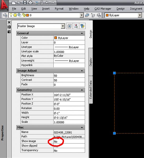

When I insert my raster image in a drawing I just have an empty box. I can't see the image. Does anyone know why?

Try the ._IMAGEADJUST command, reset the values.
Does the image show as loaded in the Image Manager?

Click on the image, go to properties, verify that "Show Image" is set to "Yes"

Thanks Buzz but i still cannot see the raster image. Thanks for the help though.
So far I have tried the following
-Check the image manager to see the path and whether it is loaded
-Tried changing the image to .jpeg , .gif and .tiff
-Clicked on properties, show image and ensured that it is set to "on"

The only time that the image shows for me is when I am in 2D wireframe mode..If I switch to 3D wireframe or hidden,flat shaded,gouraud shaded,flat shaded,edges on,the image will go away leaving a empty box..it only shows with 2D wireframe..Mike
