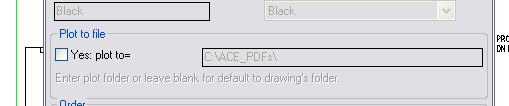

Thanks for all the replies. I found out what was wrong. I had the correct settings for the model/layout, the correct dwg. to pdf, but i had the box checked that said "yes: plot to= " (see attatched)
I was trying to save the pdfs to a specific folder on c: but when i unchecked that box, it worked correctly, the only difference is it put the pdfs in the folder where the drawings were instead of in a different folder.
