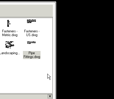

To your second one use Design Center (press Ctrl+2).
Yes I went there, but I cannot drag or copy blocks from one drawing to another :-(
Sorry I misunderstood your question. Without actually having the drawing you want the blocks to be copied to there is no way that I know of to do that.
Windows clipboard does is capable of holding more than one object but I don't think it works for AutoCAD.
Design Center does allow you to drag and drop blocks from one drawing to another.
This doesnt work here :-(
How do you do this?
How do you do this?
Drag and drop or right-click and insert.

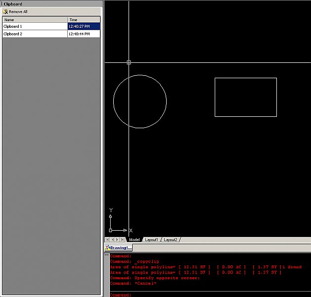

sounds like a job for the new autodesk Clipboard command, utility.
labs.autodesk.com
Plugin of the month, Clipboard
labs.autodesk.com
HaHaHaHa
Talk about collective consciousness. That's pretty awesome. I really like the option to rename.
