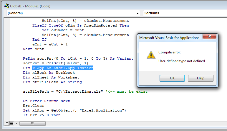

I'm using Autocad 2014 and MS Office 2010. I used VB in autocad appear error. Please, help me.
Thank you very much.
Hey, plz use the lisp code. I tried both. The VBA code gave the same error as yours, but the lisp code works fine!
Thanks fixo! The lisp code works fine! You are such a great helper!
