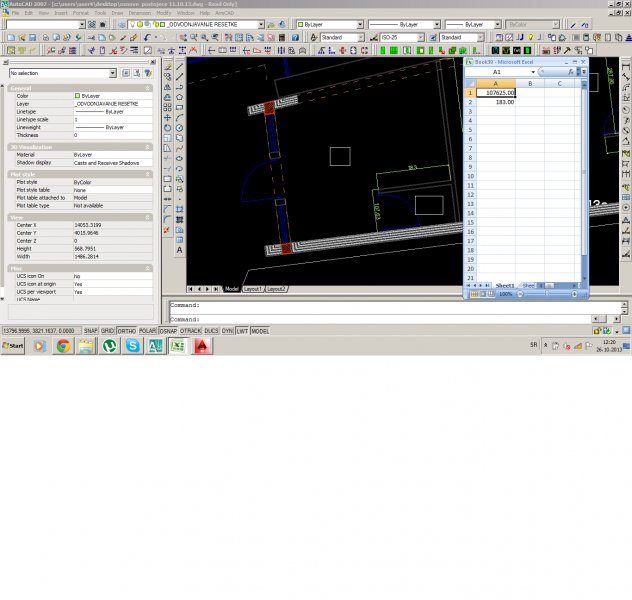

bojanamit Posted October 26, 2013 Share Posted October 26, 2013 fixo, i need help with lisp U call dx (dimension value in excel)....it's work fine when dimension have no comma (example if is dimension 423 in excel I got 423, but if is dimension 423.15 then in my excel sheet i got 42315.00 )...i use this for making bill of quantity. So in one row I have dimension like in a cad, corect, and dimension #### incorect...I need help it's burning...ty...sorry for bad english and spelling! Quote Link to comment Share on other sites More sharing options...
fixo Posted October 26, 2013 Share Posted October 26, 2013 Welcome aboard, bojanamit! Please take a look at my response in posts #10 & #12 Quote Link to comment Share on other sites More sharing options...
bojanamit Posted October 26, 2013 Share Posted October 26, 2013 so it look like this...If aligned dimension is not decimal lisp work fine, but in thi s case i have this! Quote Link to comment Share on other sites More sharing options...
bojanamit Posted October 26, 2013 Share Posted October 26, 2013 i saw that so many times but nothing...now I check or unchek some tabs in excel options ( i don't know whic one )) ) and it work fine...TY fixo, U r GREAT! Quote Link to comment Share on other sites More sharing options...
fixo Posted October 26, 2013 Share Posted October 26, 2013 Glad, you solved it by yourself Cheers Quote Link to comment Share on other sites More sharing options...
