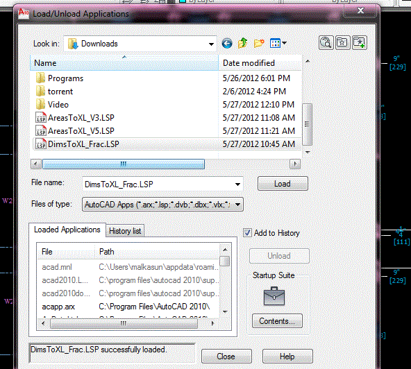

this lisp not working autocad 2010 & excel 2010. pls develop this for acad2010
Tested on A2010 Win7 Excel 12.0
working good for me
Change file name within the code to your suit
~'J'~
working good for me
~'J'~
C:\\ImportDims.xls is this file auto create or manual create.
1.tools> load application
2.load successfully.
3. get linear dimension tool take a measurement.
4 but no *.xls file create in disk c
pls tel step by step how to work this lisp application.
Do you have a privileges to save this file on disk C:\ ?
Try to save it in another folder, and also you can change
file extension on ".xlsx" instead of ".xls"
Just an idea, sorry
~'J'~
