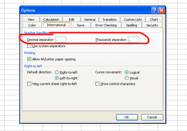

Butch Posted November 5, 2009 Author Share Posted November 5, 2009 mdbdesign has a point here. Autocad uses lenght dimesion of 3.45 m but writes at dimesnion a value of 3,45! decimal comma and period! Quote Link to comment Share on other sites More sharing options...
Butch Posted November 5, 2009 Author Share Posted November 5, 2009 I tried changing dimesion style (decimal separator) from comma to point, but it doesnt work also :-( Quote Link to comment Share on other sites More sharing options...
fixo Posted November 5, 2009 Share Posted November 5, 2009 Oleg, can dimension data be extracted to excel in fraction format??? Hi bro I never worked with fraction in Excel so I have no clue ~'J'~ Quote Link to comment Share on other sites More sharing options...
fixo Posted November 5, 2009 Share Posted November 5, 2009 I tried changing dimesion style (decimal separator) from comma to point, but it doesnt work also :-( How about this: (vlax-put-property xcel "NumberFormat" (vlax-make-variant "0,00" ;<-- change on comma here ) ~'J'~ Quote Link to comment Share on other sites More sharing options...

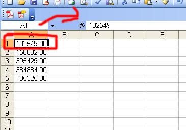

Butch Posted November 5, 2009 Author Share Posted November 5, 2009 This is the difference: numbers over thousend are differently displayed Quote Link to comment Share on other sites More sharing options...
fixo Posted November 5, 2009 Share Posted November 5, 2009 This is the difference:numbers over thousend are differently displayed Sorry no more ideas in my dim brain ~'J'~ Quote Link to comment Share on other sites More sharing options...
Butch Posted November 5, 2009 Author Share Posted November 5, 2009 Fixo, its working! I think the problem was that we had different options in Excel for decimal commas and periods. Look at the pictures! This are youur settings, right? I made them like that and it works fine now :-) All this time my settings in Excel where other way around! Its ok now :-) Thanx a lot! Now we must have a lisp for measuring area of an closed polyline. Thats a must! Quote Link to comment Share on other sites More sharing options...
fixo Posted November 5, 2009 Share Posted November 5, 2009 Fixo, its working! I think the problem was that we had different options in Excel for decimal commas and periods. Look at the pictures! This are youur settings, right? I made them like that and it works fine now :-) All this time my settings in Excel where other way around! Its ok now :-) Thanx a lot! Now we must have a lisp for measuring area of an closed polyline. Thats a must! Main Got! It's so easy Shame on my head Cheers ~'J'~ Quote Link to comment Share on other sites More sharing options...
