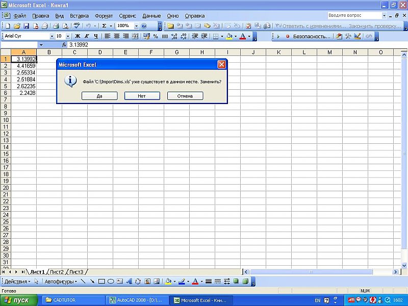

Fixo its working, but theres a little problem.
eg. the values in acad says 3,14m, when copied to excel it says 313.992
Its a little extra work in Excel no problem, but can the values be the same in Acad and in Excel?
Thanx :-)
Thanx :-)

p.s. I used the .lsp file
It's strange
This lisp works good on my end
I have Excel2003 on my machine installed
See attachment
Check Excel file - perhaps there are
some formulas into the cells was embedded
Another thought
Try to change this line:
(vl-princ-to-string (cdr row_data))
on:
(rtos (cdr row_data) 2 2)
~'J'~
Now I get dates!
for egsample value of 3,14, I get marz.14
2,55 --> Feb.55
Now I get dates!
2,55 --> Feb.55
Aha, problem is in the NumberFormat properties
Change on this piece of code
   [color=blue](vlax-put-property xcel  "NumberFormat"
     (vlax-make-variant "0.00" ;<--"0.00" change on what you need (see patterns in Excel-Format cell)
     )[/color]

I doesnt work here :-(
I have Auticad 2007 and Excel 2003.
I attached the .dwg file and excel file.
Only the first value is correct :-(
a1.dwg

Veyr frustrating :-(
Fixo, when you activeate the dx.lsp then select dimesnions and hit enetr do you get an message "close Excel file only"?
I hit OK then and Excel opens.
Does this happens also to you?
Can you write in Excel numer 10000 and number pi (3,14) decimal comma is used.
If I write 3.14 with decimal point in Excel I egt year dates! In this case marz.14
There must be something wrong with this marks! , and .
