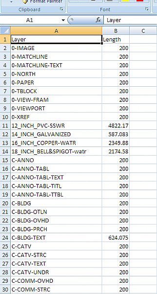

All that's left is to put that into excel. I can put it into a csv file for you, but I'd have to dig around to put it into excel for you. Maybe someone else will chip in...
Steve a csv file would be awesome! I can use that just as well!
That is exactly what I need!
I'd be more than happy to help you with dynamic blocks as a thank you, but you're probably light years ahead of me on those, too!
How's this?

:) Thanks Alan, I tried to keep it general but it got a bit specific/amateurish towards the end. (eg (write-line "Layer,Line Length" fl) is out of place)
Don't sweat it dude. :) I did notice that you didn't combine lengths if more than one line existed on a layer. I hope you don't mind, I gave it a shot myself.
