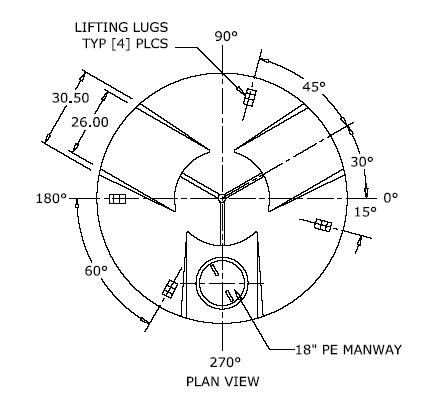

Tankman Posted November 4, 2009 Posted November 4, 2009 Tedious what else? Tiger is correct, import as an image or convert to *.dxf. Might you have Adobe Pro? Attached *.jpg was a "Snapshot" taken in Adobe Pro 6 and pasted into M$ Paint. The result was saved as a *.jpg image. If the *.pdf was a scan, would be a bit cleaner if converting if the *.pdf had been created (output) in AutoCAD. Originally this was a scan. This image was indeed a "Snapshot" taken from a *.pdf which was indeed generated in AutoCAD. I created the *.pdf in AutoCAD which I made using this same routine. The image *.jpg was inserted into AutoCAD '05. Image using "Draworder" was sent to 'B' (Back). I then using red so I could see on the white, drew a horizontal line and a vertical line, using the intersection, a circle. The circle measured 2+ inches, I scaled up to 92" which I needed. The rest, given dimensions and a bit of fudging, isn't terrible but, could as Tiger states, "A bit tedious." Have fun. After you've got enough, un-attach the image and get workin'! PS. The image and drawing have to be in the same file to view; i.e.: My Documents (temporarily). 1200_Snapshot.dwg Quote
