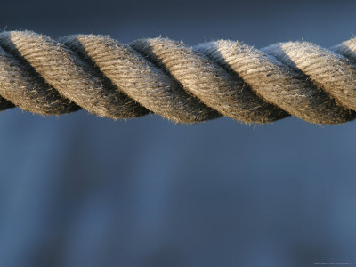

have a question a quick one - how to model (but really model a rope)
you can get two or three basic threads that when curved in a helix can be made into a rope, but how to make all those little lines /threads/ - they can be made by textures (+bump) but is there a way to model them
i'm thinking it's impossible since it almost appears you need to make a helix with gzillion turns and have it bend by a helix, and don't see how you can make that
i'm posting a quick photo as a reference so you get a better understanding of my question
p.s. i know that the file size of this model would be like the combined weight of the empire state building and people in it, but i'm just wondering :)

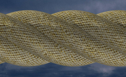

I did this in about 5 minutes in Inventor. I imagine if I experimented a bit more it would look closer to real rather than cosmetic texture.

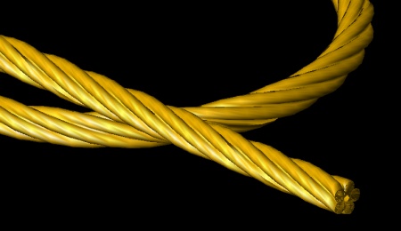

I wrote an Autolisp routine to model rope as a surface entity extruded along a 3DPOLY path. Fun project. Limited to 255 vertices and you have to make a profile. But it worked. -David
