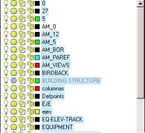

Any idea why my layers display has a blue highlight around the names as seen in the attachment? I'm not sure what I've done to make this happen. Comments? Thanks
Edit...this is on the layout tab only. (paper space, not papaer space!!)
Layer State Manager (button is at the top left of the Layers Dialog Box). Highlighted in blue means those layers have a 'viewport override' on them. Property overrides areused to display objects with different property settings in individual viewports without changing their properties.
Well, I did create 5 layer states in model space, but I don't ever recall seeing this before in the layout space. I did not intend to create any viewport overrides. Thanks for the reply.
