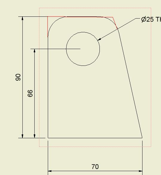

Toolish Posted July 24, 2008 Posted July 24, 2008 A lot of the parts I model are plates that are not square and have filleted edges. I am trying to work out how to get the dimension that would be to the straight edge before the part was filleted. I have attached a section of the drawing. How can I get a dimension on the drawing showing that top red line length. thanks Quote
Opc 12 Posted July 24, 2008 Posted July 24, 2008 Select the edge of the fillet (the circle quadrant). Good luck. Quote
WagglyFawn Posted July 24, 2008 Posted July 24, 2008 OPC, I believe he's asking how to dimension the intersection of the two lines that were filleted and not the radius of the fillet itself. I'm assuming you're dimensioning a sketch in a part file and not dimensioning an Inventor dwg file. EDIT: Nevermind, I just looked at your picture again. That's a drawing... Okay, select one of the two lines you want to dimension, and then right click the other line and select "Intersection". You'll see that when you mouse over the second line, a point will appear to select and dimension from. It's quite simple, just add the dimension you want BEFORE you make your fillet. Then, when you fillet that corner, the dimension will stay and you'll see that point was created to represent the apex of those two lines. Quote

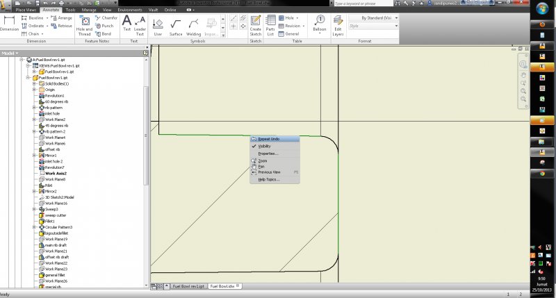

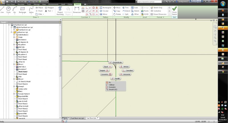

sandipurwo Posted October 25, 2013 Posted October 25, 2013 [/ATTACH] I can't do this trick. Is there anyone could explain this ? I've tried this trick in sketch mode (mode2) and in default drawing mode (mode1) but it didn't work. Quote

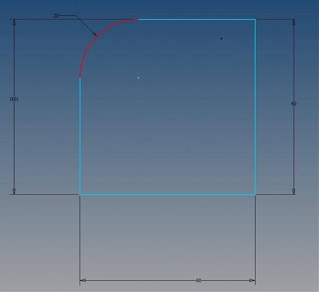

Faouweb Posted October 25, 2013 Posted October 25, 2013 Hi, What you can do is drawing a sketch in the IDW and then add the dimention as shown in these picture: Quote
