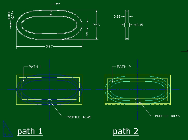

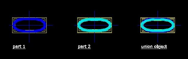

ica_cici Posted October 28, 2009 Author Posted October 28, 2009 Actually, i need to make this shape in solid (see picture), and this following are the procedures: Making 2 pline paths. Sweep-ing a circle profile (D=0.45) along paths.(using sweep because it won't work with extrude command) Merging the two solid objects result into one using union command.(failed) Subtract-ing each solid objects by 4 boxes above and below the left & right sides so the thickness left to d=0.28. Subtract-ing one end point in order to get gap=0.0001. Merging the two result solid objects into one using union command.(failed and still separated) What is the problem caused by? is it because of my path?(because it's usually work with extrude and union commands if the pline made of circle and line). Thanks for help!I also enclosing the dwg file. JOINT-1.zip Quote

ReMark Posted October 28, 2009 Posted October 28, 2009 You can't join the ellipse and pline because the system variable for pellipse is probably set to "0" and not "1". Personally, it looks like the two paths overlap for most of their length. Why is that? Quote
rocneasta Posted October 29, 2009 Posted October 29, 2009 ever since Autocad introduced history into 3dmodeling - only i guess to be able to use solidedit commands - at times it's impossible to UNION the solids that have history on record. use BREP on your solids before UNION and it might help. If it doesn't, and in some odd cases it won't i never found the answer why Quote

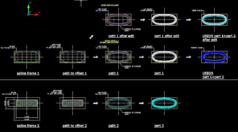

ica_cici Posted October 29, 2009 Author Posted October 29, 2009 No, BREP doesn't help my solids. I renew my paths and i think I've been figure out what the problem is. I am using spilne as a path frame and redraw the path frame with arc-pline, then offset-ing the new arch-pline at distance 0.225. I did it for the both paths and wanna use the middle arch pline (offset results) as the main path. But, the main paths points are not precisely in correct and perpendicular with the frame so i made some edit for its. After extruding the two paths and trying to union again it's failed. So, i repeat the steps once again, but without editing the middle arch-pline (main paths) this time and reunion its again. It works, its joined. The big question in my mind now is why editing offset path can make the union process failed? joint-2.dwg Quote
ReMark Posted October 29, 2009 Posted October 29, 2009 Perhaps there was a gap somewhere that went unseen? Quote

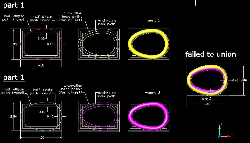

ica_cici Posted October 30, 2009 Author Posted October 30, 2009 I call it chain's link. No it isn't, it supposed to be full solid. And about the offset, when i am offsetting an ellipse, it would be a spilne and it's point are no longer in the right frame points. Is it always like that? Here another case (see picture), and i cannot joint them with union too although I'm not editing the path. I think I can't trust my self anymore about the union, it make me desperate joint-3.dwg Quote
ReMark Posted October 30, 2009 Posted October 30, 2009 I don't get it. The two parts are almost identical. Why are you trying to union them? Quote
ica_cici Posted October 30, 2009 Author Posted October 30, 2009 I want to get the sizes in 0.50 for the wings (upper & lower) but still in 0.40 for the both ends (left & right). Quote
ReMark Posted October 30, 2009 Posted October 30, 2009 Then why not draw cross-sections for each critical thickness transition and use the loft command to create the shape? Quote
ica_cici Posted October 31, 2009 Author Posted October 31, 2009 It's should be a solid wire with thickness d=0.40, if using loft the profiles to loft are a circle with D= 0.40 at the end (left/right side) and an Ellipse 0.40 x 0.50 at the middle of one of the wings, is that what you mean? Quote
ica_cici Posted November 2, 2009 Author Posted November 2, 2009 I've been trying the loft option for the both cases and it works. Thank you ReMark that's a brilliant idea! The results are smoother and that's easier way. joint-4.zip Quote
