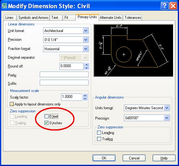

For the life of me I can't figure out how to get my measurements to look like 1'-0" as opposed to just 1' now....how do I make it add the -inch measurement no matter if its 0?
Check your precision under the dim style settings? It will be in the Primary Units tab.
