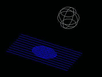

I have a .Net routine in development (AutoCAD 2009+, though not tested on 2010) that allows drawing on any face of a solid. Actually, it is more a mapping routine (compared to on surface drawing) but it may be of some use. I’ll post the DLL if anyone is interested.

To perform a mapping operation, first:
Command: Netload
Navigate to the appropriate folder and select CsVectorMap.dll
Then:
Command: CPM
To create “canvas” border of a selected face.
[border will always be near WCS origin. The code responsible for the general shape and scale of border still needs some tweaking].
Create some geometry within the canvas border.
Finally:
Command: CVP
Select the “canvas” object, then select all the lines and curves to be mapped.
Warning: This is a beta routine and should be used with sensible caution. Save all working AutoCAD sessions, isolate pertinent geometry into its own file, then return mapped geometry back to it’s final location.

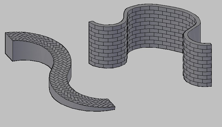

This doesn’t necessarily relate to the original post but shows another potential use for the beta routine attached above.
