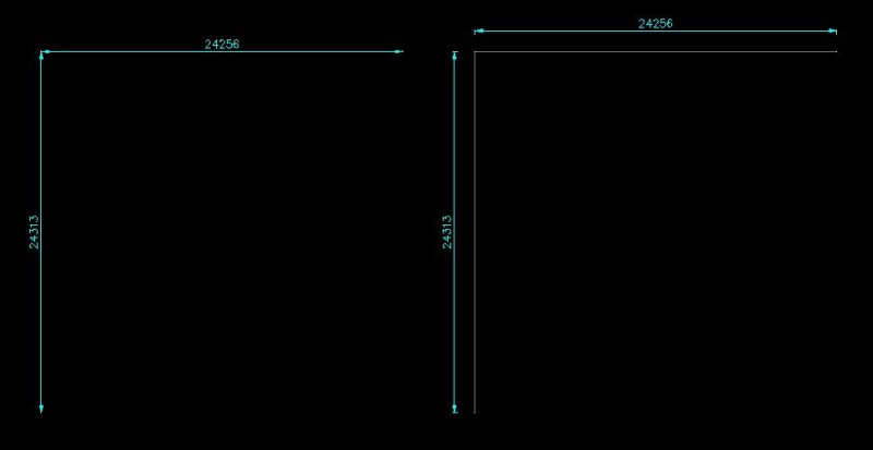

Fixo is there a way to alter this lisp routine so that the dimension location falls in a different location parallel to the line it is dimensioning but offset from it by say 200mm? or can this lisp be altered to a rotated dimension rather than an aligned one?

Thanks Fixo. below i have drawn four lines and used the lisp routine to dimension the two on the left hand side and dimensioned the two right hand lines manually, as you can see the left hand dimensions are sitting directly on top of the line they are dimensioning, whereas the ones i did manually are offset from the line so that the line is still visible, any help would be appreciated :)

@tjfisher
sorry for the belating,
try this code instead
(defun C:mdm (/ elist en  i p1 p2 pc ss)
(command "_undo"
"_be")
(setq ss (ssget  (list (cons 0  "LINE"))))
(setq i -1)
(while
 (setq en (ssname ss (setq i (1+
i))))
 (setq elist (entget en))
 (setq p1 (cdr (assoc 10
elist))
   p2 (cdr (assoc 11 elist))
   pc (mapcar (function (lambda(a b)(* (+ a b) 0.5))) p1
p2)
 (command "_dimaligned" "_non" p1 "_non" p2
"_non" pc )
 (command "_dimtedit" "_L")
 (while (eq 1 (logand
1 (getvar "cmdactive")))(command pause))
 (command "_undo"
"_e")
@fixo
thats great Fixo many thanks.
just a minor question, is there anyway of keeping the dimension text centered on the dimension line?
my dimension style is set to Text Placement, Horizontal: Centered, but the lisp routine seems to overide this?
many thanks for your assistance :D
Try another routine, you can specify
offset dimline from line entity transparently,
say specifi direction and type gap size.
I've added one line of code to set dimtext 'Home' :
