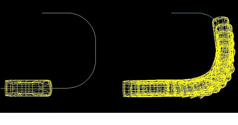

lonie Posted October 19, 2009 Posted October 19, 2009 I use a lisp that moves a body around a poly line; it does this in a sort of stepped animation. I would like to modify the list so that it leaves body prints behind. Being new to lisps I can't work out how to do this. I've attached the lisp i use. The jpg shows what I'm after if I can get a modified lisp to run. What am I missing ? mst (ssg).lisp.txtFetching info... Quote

lonie Posted October 20, 2009 Author Posted October 20, 2009 Hi Carl / Alanjt, The body is in fact a car shell that is swept / stepped around a conveyor. The two circles inside the body must be constantly on the pline. I use it to explain how a body moves around on conveyors for clash detection. I cut and pasted the mod in with no joy. Quote

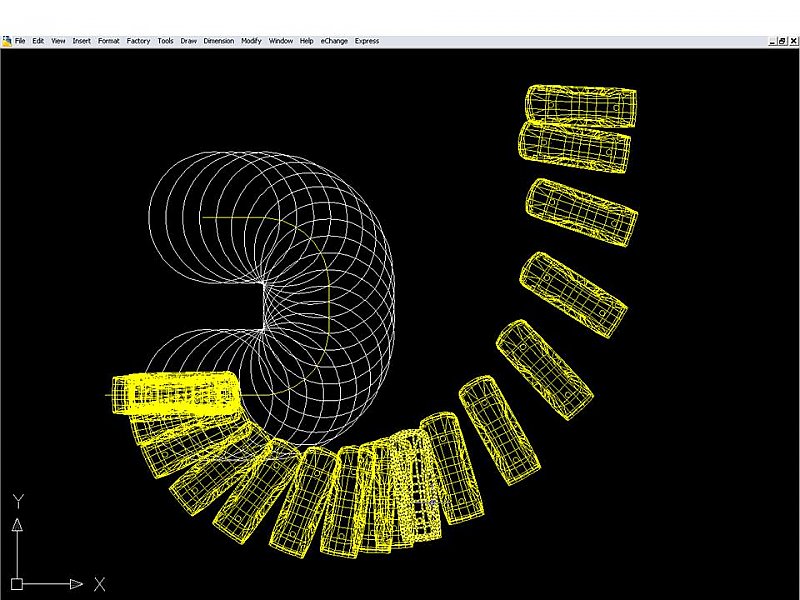

lonie Posted October 20, 2009 Author Posted October 20, 2009 Have ran the lisp and this is what I get, it does leave a copy but doesn't follow the path. Quote
lonie Posted October 21, 2009 Author Posted October 21, 2009 Finally got it to work, inserted copy after it aligned itself. Just to close off the thread I've shown the change. Thanks ;;;------------------------------------------------------------------------------ (defun moveStep() (repeat (length pL) (setq p3 (nth j pL)) (setq pa3 (vlax-curve-getParamAtPoint cur p3)) (if (>= (* flag pa3) (* flag pa1)) (progn (command "circle" p3 r) (setq ipL (ints cur (entlast))) (if (> (length ipL) 1) (setq p4 (getnearP p1 (car ipL) (cadr ipL))) (setq p4 (car ipL)) ) (command "erase" (entlast) "") (command "move" ob "" p1 p3) (command "rotate" ob "" p3 (rtd (- (angle p3 p4) ag))) (setq p1 p3 ag (angle p3 p4)) (command "copy" ob "" p1 p3) ;inserted copy after the block is aligned (command "delay" 100) ) ) (setq j (1+ j)) ) ) ;;;===================MAIN==================== Quote
