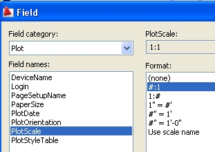

In Inventor, Is there a simple way to put a field in the Titlebox with the PlotScale.
In MDT you can insert a Field and then pick the properties.

In MDT I would just list the scale of an entire drawing with a field in the Title block.

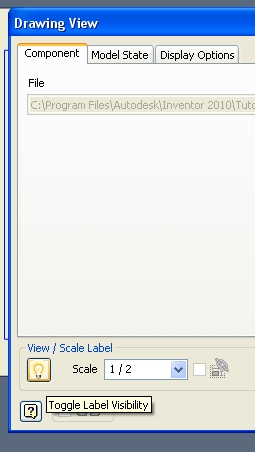

I found out how to turn the visibility on the view scale.
Click on the little light bulb Icon.

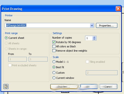

I usually make a "B" sized drawing Full Scale, but occasionally I like to quickly Plot out a letter size print "A" size on the Laser printer.
I select the check box Fit to paper, and then the Plot scale automatically changes to whatever the actual scale is.
I can save different Page Setups, so that I don't have to have a bunch of Layouts.
I name the page setups "BFull", "AScaled", or whatever.
I wonder if this is even possible with Inventor?

Best Fit sets the sheet scale to the paper size.
Is there a way to print this scale whatever it ends up to be, on the drawing?
