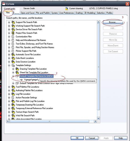

stevsmith Posted October 13, 2009 Posted October 13, 2009 Set the qnew to the file that you want in tools>options>files As shown below Quote

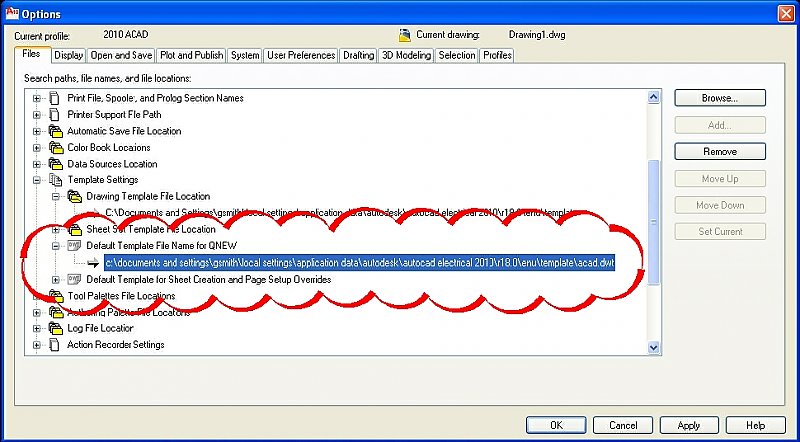

Glen Smith Posted October 14, 2009 Posted October 14, 2009 Have you got a DWG that has all the defaults that you want to have? Save that drawing in the templates folder with the filename acad.dwt. Unless you changed the defualts, this will be the drawing that opens when you launch AutoCAD. In Options - Files - Template Settings there is a selection for "Default Template File Name for QNEW" select it and click browse, then select the acad.dwt file that you saved above. I think that this will do what you want. Glen Quote
