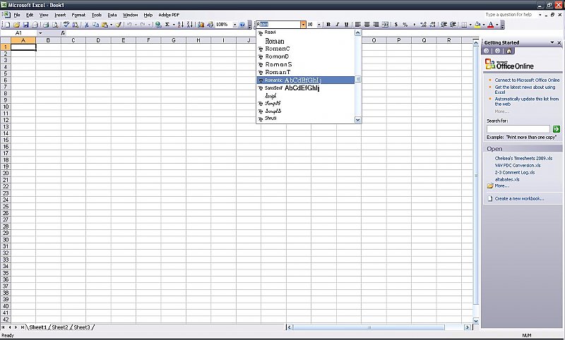

chelsea1307 Posted October 12, 2009 Posted October 12, 2009 My excell has RomanS, thats my companies standard font, another thing you might face is issues with printing, i could not get romans to plot right when in a autocad table that was linked. I dont know why, if i typed it directly into the table it plotted fine but if it was linked to excel it plotted really light, only font with the problem Quote
