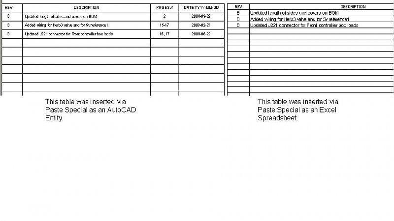

ziemerd Posted October 12, 2009 Author Posted October 12, 2009 I've attached a JPG to show the difference between the two tables inserted differently in AutoCAD. I'm trying to reduce the size of the table that I pasted as an AutoCAD entity but I can't get it to reduce by selecting the table and clicking on the blue triangle. The text height is at 2 and the cell height is at 6.6. There's plenty of room to reduce the table but it won't budge. Quote
ziemerd Posted October 13, 2009 Author Posted October 13, 2009 I realize text height has a control on row height but I want to get the row height tighter to the text. Is there a way to do this? Quote
hntrak Posted October 22, 2009 Posted October 22, 2009 I too am willing to transition from using the OLE option of linking an Excel spreadsheet to the DATALINK / TABLE option - my only difficulty so far is getting the table cells to adjust independently from the text size and vis-verse ... the DATALINK option makes too much room around the text / values as Ziemerd has stated (above). I would appreciate any assistance in this. Thank you Quote
EdCycler Posted October 22, 2009 Posted October 22, 2009 There is a vertical/horizontal cell margin property. Highlight the column/row/cell and select property. If you are using data link the table may have to be unlocked. Quote
