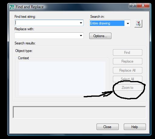

Yes, i think you can rightclick mouse anywere on the screen and choose the "Find" command, there you can type what you want to find.
Krztoff,
I checked that but it no use its good for changing text but I can't locate in drwaing
When you press the find button, doesn't it zoom to that text? For me when i type in the symbols that I need to find and press the "find" button it automaticaly zooms to that symbol and i have it on screen.
one of the options (at least in 2008 ) is to "zoom to".
yes it zooming but for editing mode i Dont need edit this but I need to know where is the location.

it in 2008 but not in 2009, I checked. For this work I can do that thru Zoomto commend but somebody know better than this please tell me

Sorry ruksi but I have to disagree with you.
Annotate Panel > Text tab > Find text. Or...
Browser Menu (Big red A) > Edit > Find. Or...
Toolbar: Text Formatting. Or...
Command entry: Find.
When the Find and Replace dialog window appears type the text you wish to find in the Find what box then click on the Find button. AutoCAD will automatically zoom to the first instance of that text it finds. If there is more than one instance of the text the Find button is replaced with Find next. Click on the button. AutoCAD immediately jumps to the next one. Repeat as necessary.
Don't forget to take advantage of some of the other Find and Replace options such as List results, Search options and Text types. Find may be more powerful than you realize.
ReMark, actually I was telling Find command is thair but in that dialog box didn't have zoom to command, & 2009 It particularly use for change the waord Which we are find, So this is not I am searching, Ex. in my main drawing lots of doors are thair but verious type, so in that one door no i am searching where the location how many tim come How i do this
You want to know how times a certain word is appears in a drawing? Use the List Results option.
