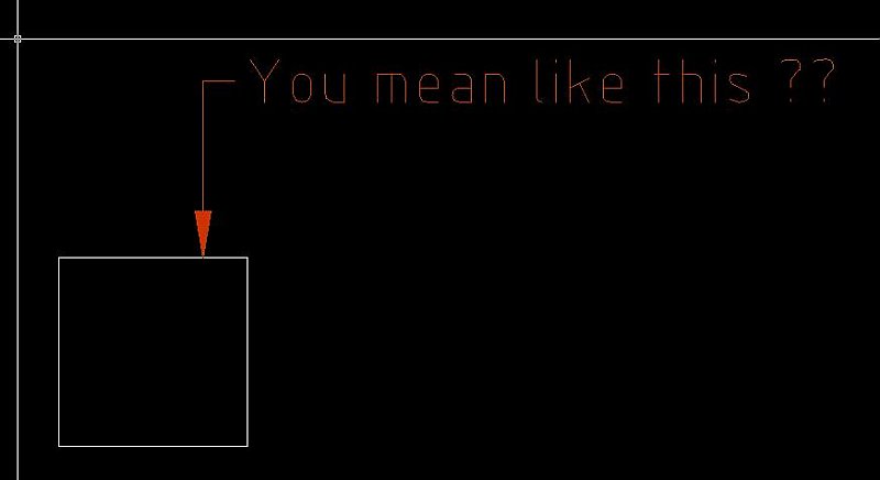

mgonzales Posted October 7, 2009 Posted October 7, 2009 Need help i do not know the first thing about writing a lisp routine. I was hoping that someone might already have a flow arrow routine or be able to instruct me how to write one. i am looking for a leader with an arrow and the prompt for a test string and the text would be placed above the leader not behind it. i really appreciate if anyone can help with this. Quote

alanjt Posted October 14, 2009 Posted October 14, 2009 Dynamic block (option to flip arrow 180°) with attribute above it. That would be the easiest route to take. Quote
MarcoW Posted October 14, 2009 Posted October 14, 2009 Hello, I do not know if this is what you are looking for? And then the text above the leader... Regards, Marco. Quote
lpseifert Posted October 14, 2009 Posted October 14, 2009 Here's a dynamic block I made a long while ago, not perfect but works in most cases. I put it on a toolpalette to be inserted at the dimscale with a rotation prompt. Maybe you can gather something from it. FA-DB.dwgFetching info... Quote
CAB Posted October 14, 2009 Posted October 14, 2009 What's wrong with Qleader and the Underline setting? Quote
lpseifert Posted October 15, 2009 Posted October 15, 2009 Normally in Site/Civil drawings when annotating a flow line, say a gutter line, the arrow and text are at the same angle. I don't think Qleader can do that without changing the UCS. Quote
CAB Posted October 15, 2009 Posted October 15, 2009 You do have to change the text rotation to match the leader and the underline will follow. Quote
