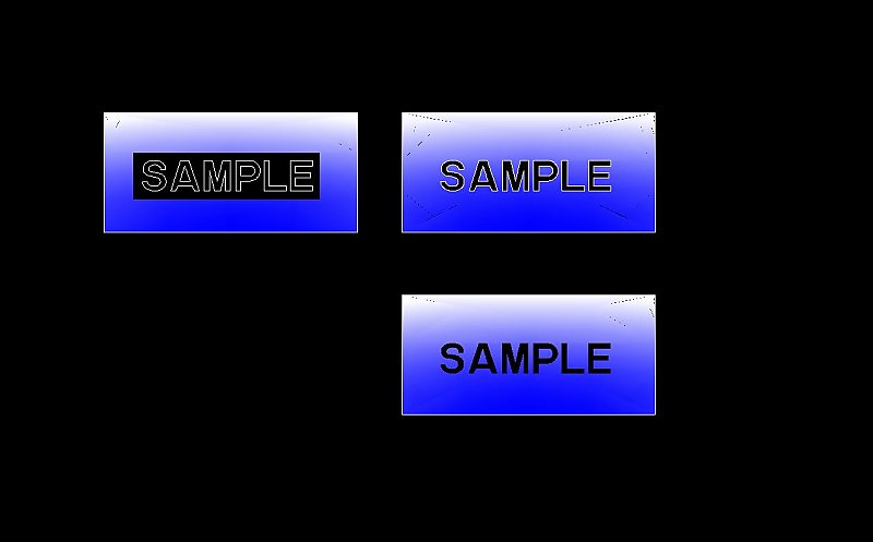

ReMark Posted October 7, 2009 Share Posted October 7, 2009 For those of you who are running a full version of AutoCAD here's another "clunky" way to get the same affect. Use Express Tools Explode Text. The difference between the upper and lower right hand images is the removal of the exploded text. Hey! I said it was clunky. Quote Link to comment Share on other sites More sharing options...
